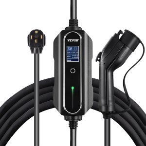

I just checked & Vevor has one of the latter for only $200:
Thanks. This is a big help
I searched Amazon a bit more & didn't see anything more appealing.
What I like about that 32A Vevor is:
  • It's only the same price as the 16A Schumacker.
  • The Vevor brand tested well for @TinyEV_PA in the 16A version.
  • The 32A in a 50A 240V outlet* will max out the car, which is fine, but it won't even come close to maxing out the outlet, which can be a fire hazard.
  • It can take 110-120V (with a $20 adapter).
  • It can be set to max out the car, or set for 10A so as to avoid maxing out a 120 outlet, which can also be a fire hazard.
*You might have to change the easy part of your 240 outlet, to match the cord's plug.
...or maybe just a $20 adapter for that, too.
  • It actually lists & shows a 1st-gen 500e! A few owners have had issues with other units, & when I looked them up the 500e was conspicuously absent from their list.
