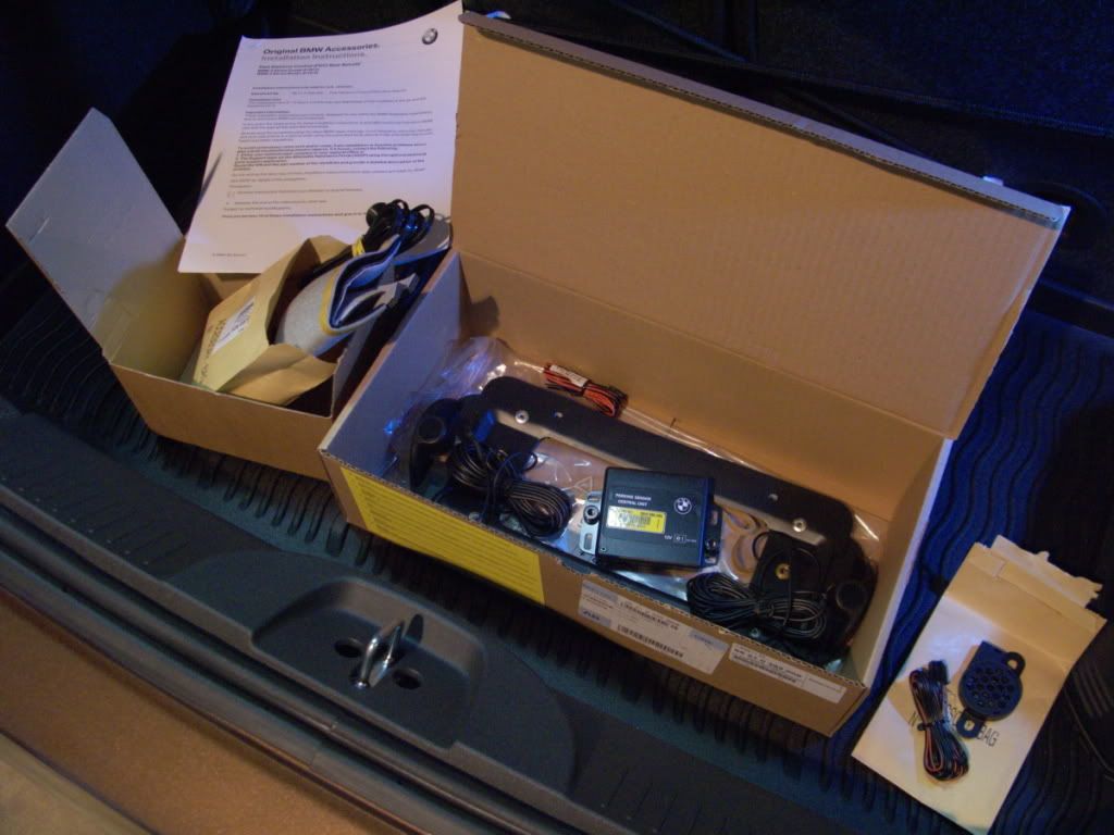

All the parts.
Before installation.

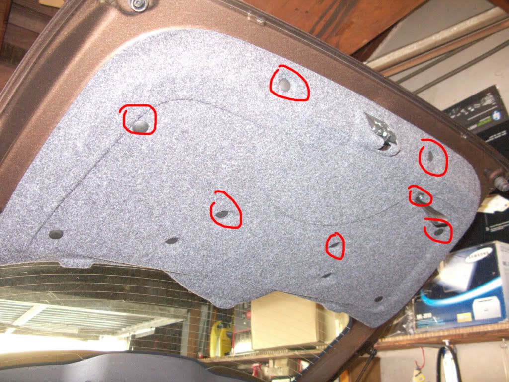

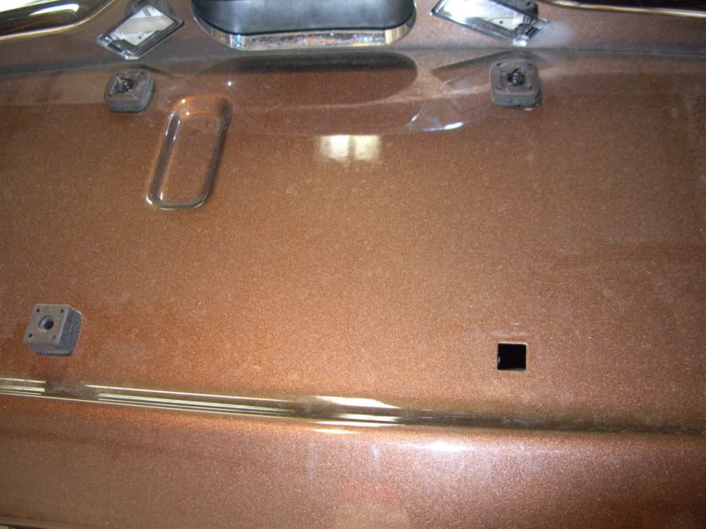

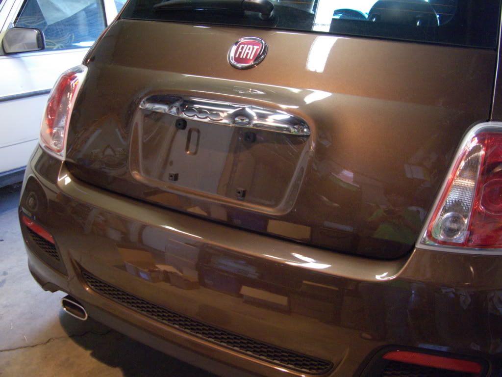

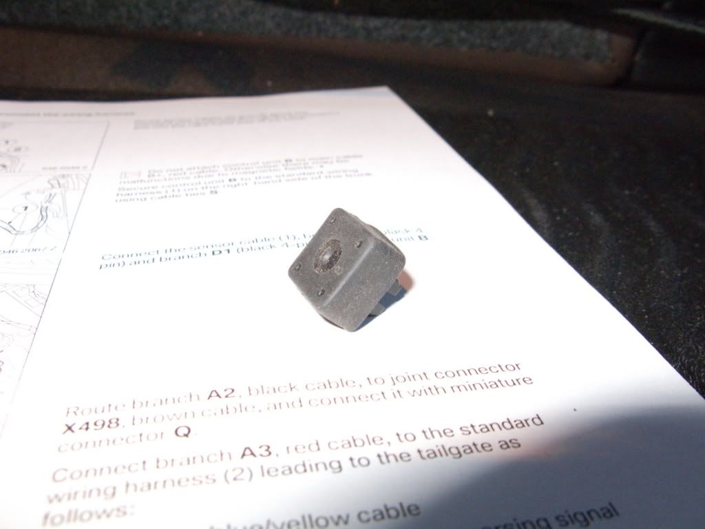

Open the tailgate. remove the liftgate door pull and the plastic pins. the pins are pretty hard to remove. I just did the ones circled in red to get enough access.

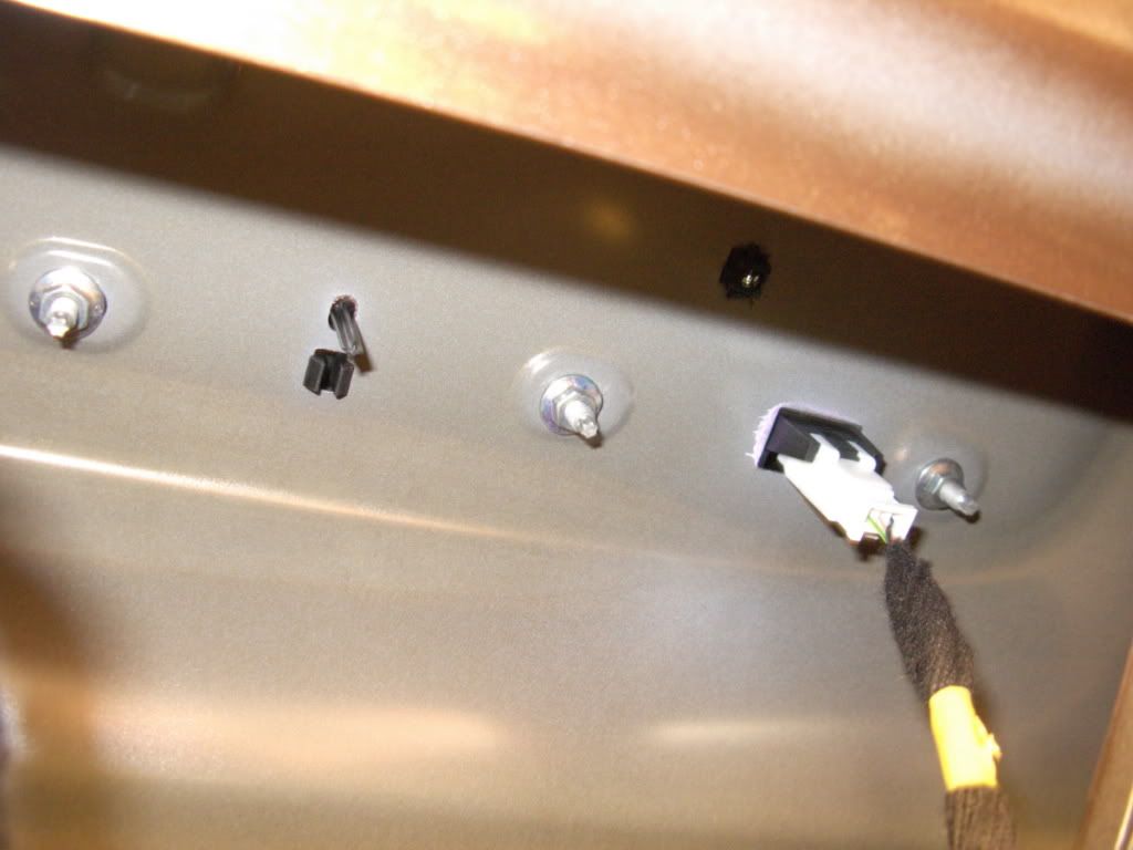

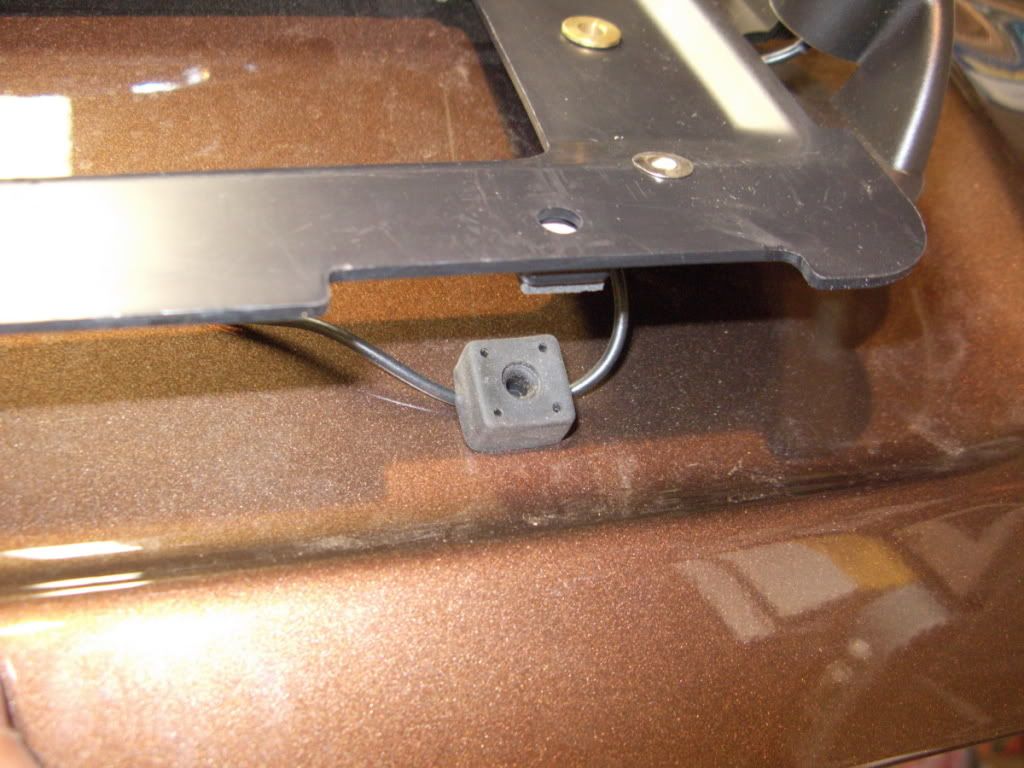

the chromed tailgate handle is held by 4 nuts from the inside. you can choose to remove theses and then run the wires of the sensors underneath the tailgate handle. but I decided to use another way.

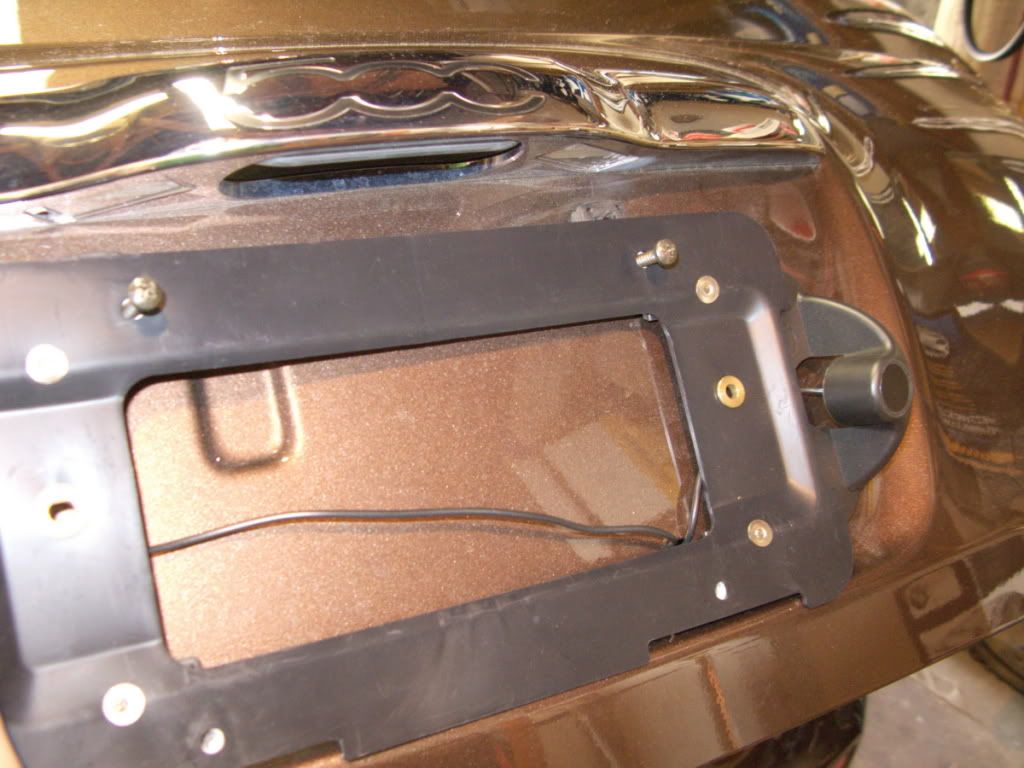

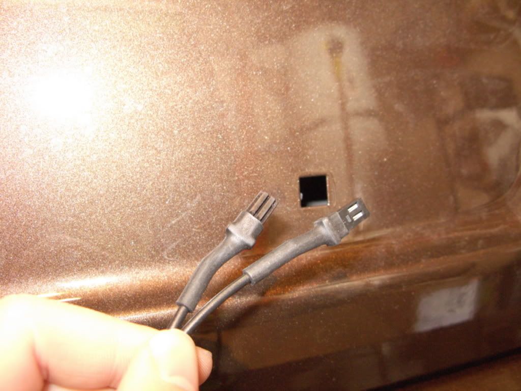

What i did was taking off the bottom right license plate mounting piece and fed the wires through the hole.

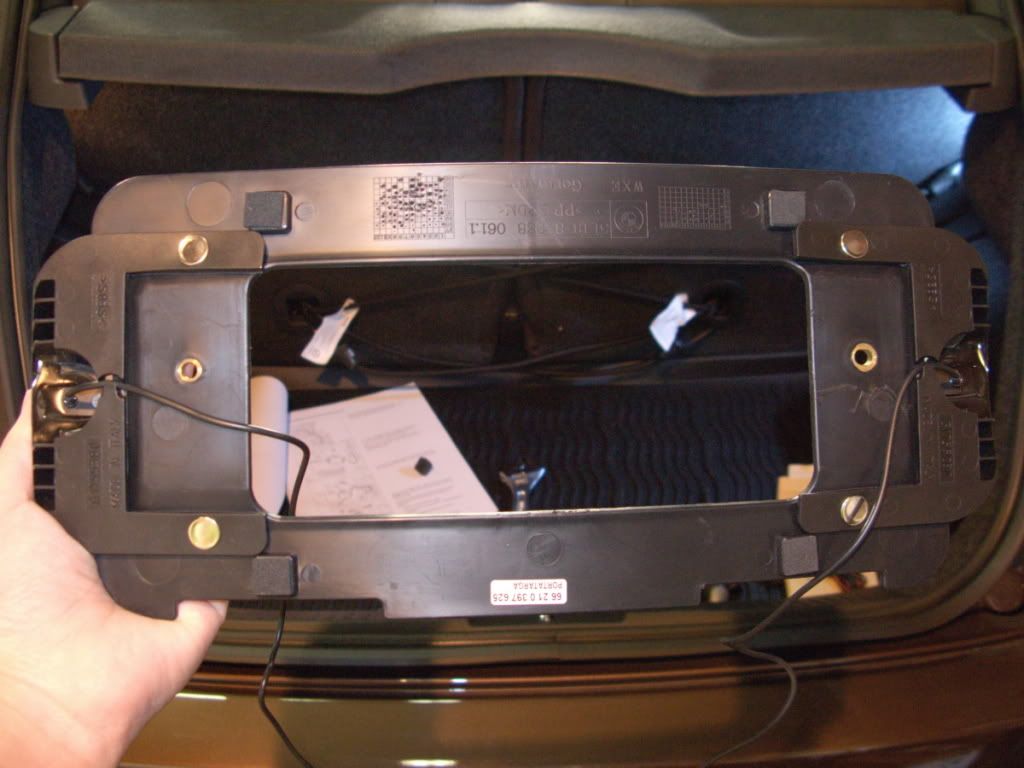

the back of the license plate bracket with PDC sensors. make sure the wires are in place.

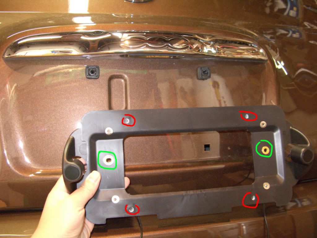

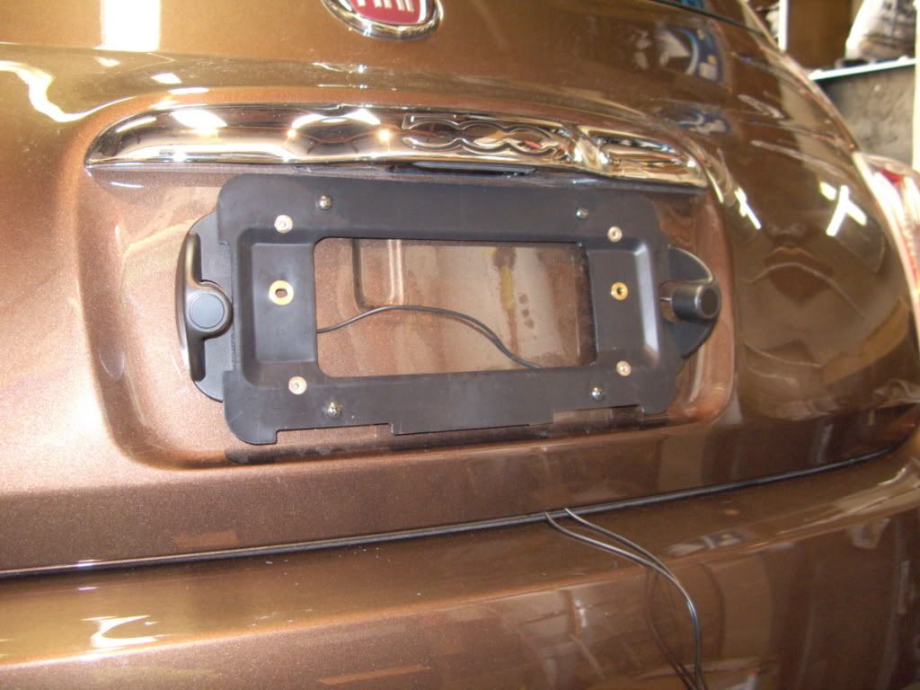

on a bimmer the bracket is mounted onto the car using the 2 holes circled in green. however the fiat does not have the mounting holes in the gate. so instead I'm gonna use the license plate mounting holes in red, using 4 of the longer screws supplied within the kit. make sure the sensors point downward.
reposition the license plate mounting piece.

If u like a super clean installation, u can run the sensor wires through the rubber tube and the inside of the tailgate frame. but i think its gonna be difficult so i just took the easy way and try to hide the wires as well as possible.
plug everything into the PDC control unit, and hide everything behind the lining.
