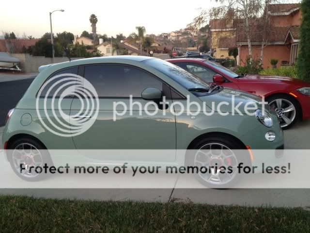

I like the look of the Madness progressive springs. Would the drop look the same if i were to put those springs on my pop?
1,059 Posts
Same as what??? It matters not what model you get - the drop will be identical.
81 Posts
Same as the pic someone posted on page1. Thanks for the info dude!
2,574 Posts
my car looks a tiny bit lower. Might be my wheel width that makes it look that way though.
123 Posts
The front has the wheels turned right a tad, making the opening look a bit larger and it is on a slope, putting a bit less weight on the front. I just checked in the garage, where it sits flat, and it is three thin fingers from the tread to the wheel well in the front and the back is perhaps an quarter of an inch more, car unladen.
