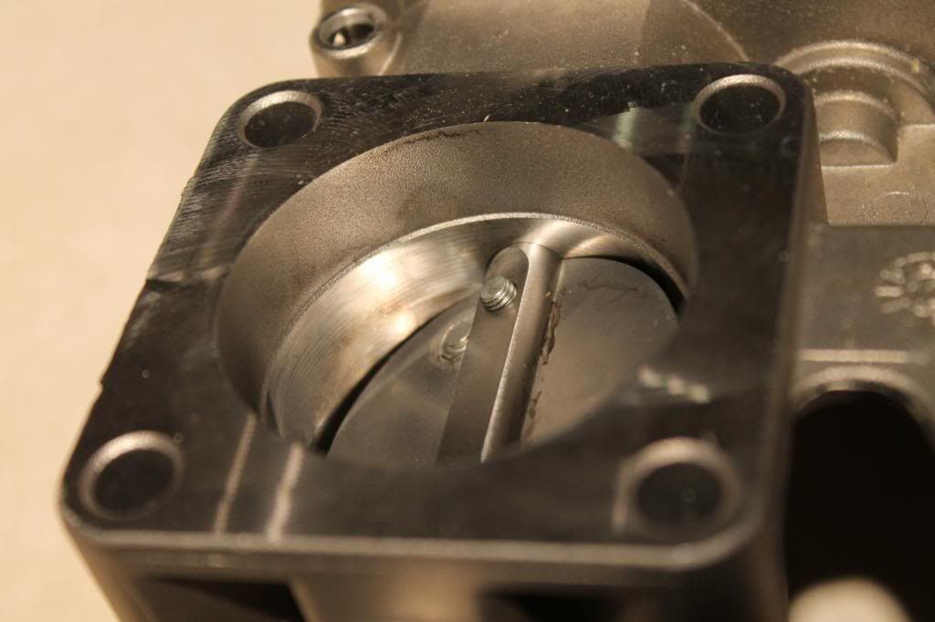

I am curious as to what type of problems they were talking about ? I have over 1000 miles on the one I bought and no issues. it continues to function as expected with no check engine lights, no function or drive ability issues, to speak of.
"It was 2mm off center so one side was paper thin and if we over torqued a hose clamp for the coupler, RC said it would crack and collapse"

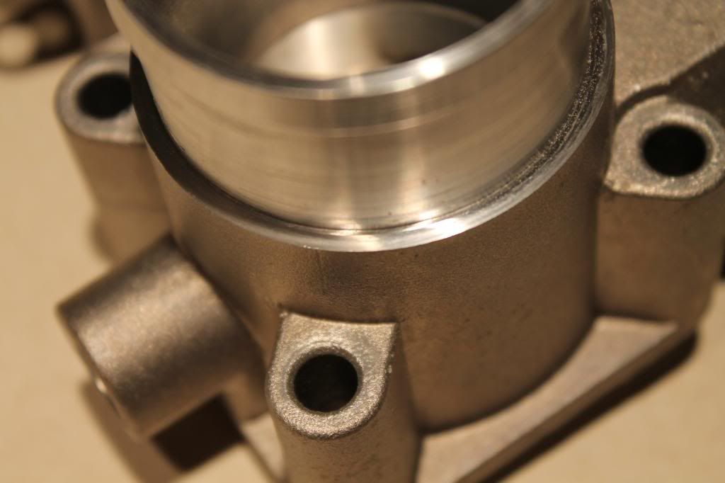

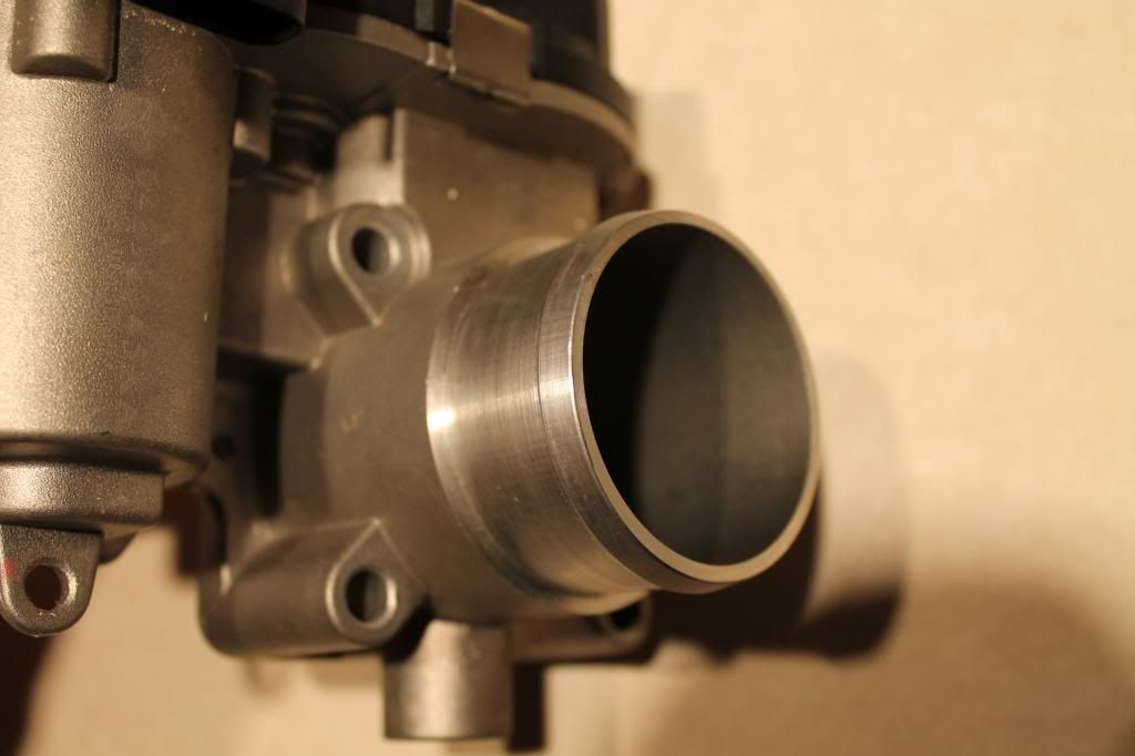

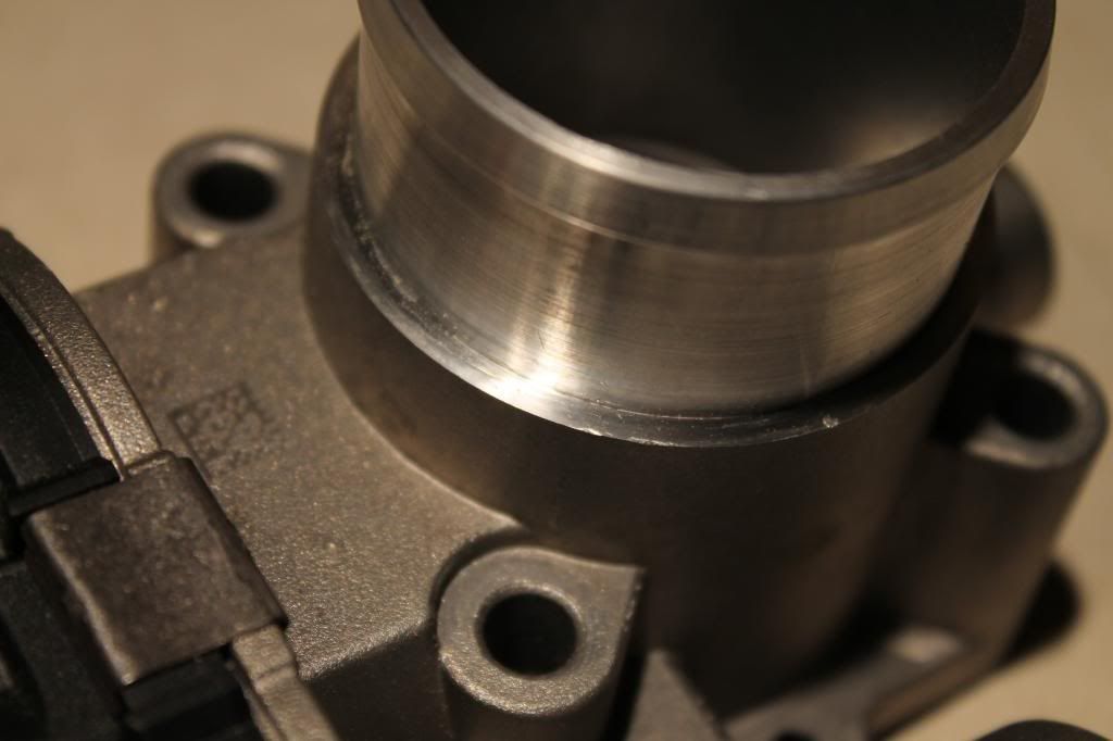

I thought this was odd when I read it. To have been that far off when they set it up to bore, actually made me worry that the jig, or set up they were using was off. I have to say I looked at the one that was sent to me over with a fine tooth comb for machine work, center of bore, left over metal shavings etc... It was spotless and the machine work was very well done all though not perfectly center. After I read this post, I went and got my original stock throttle body and looked at it also. The boar IS NOT perfectly center either, but the funny thing is the "boar is not machined, per say, the out side where the inlet hose clamps is what is machined and the factory casting was machined just a hair off center. The bore is un touched cast except where the restriction is at the base near the butter fly plate.
So the moral of the story is, it appears that the throttle body casting is not bored off center by Modern, it appears the outside factory machine work is a bit off, so like anything else, you have to look at what you purchase and deal with reputable companies. The one I received was good to go and continues to function properly. Modern assured me, when I placed my order they would stand by their product and I have no reason to doubt them.
So what I am getting at is the machined boar on the MP throttle body appears to be centered with the butter fly plate shaft and the plate it self. It is the machine work on the original piece that is off a bit. I tried to get a few pics, but it was hard to get the right angle and light.
This shows the what would be the thinner side of the bore, not by much, just a bit.
This would the thicker side. Like I said, VERY SLIGHT difference.
This shows no machine work on the inside of the original bore by Chrysler. the only machine work by the factory is on the exterior.
Better shot showing the inside bore that is left in its cast state except where the restriction is at the butter fly plate.

Your conclusions on the off center boring are the same as mine. It looks like when chrysler makes the TB, they drill out two reference holes on the bottom of the TB as locating dowels for their turning and milling fixtures.
The dowels when compared the the casting are slightly off too, so my guess is that those dowels are what is centering it when the TB's intake hose attachment is being turned and leading to the off center condition by chrysler.
Then, when MP's machine shop does their bore work on their turning lathes, it is not being referenced by the dowel holes and chrysler's special fixtures, but most likely a more standard issue internal 3 jaw chuck when boring the ID of the TB.
In other words - MP's work is more centered and true to the casting than Chrysler's :)
