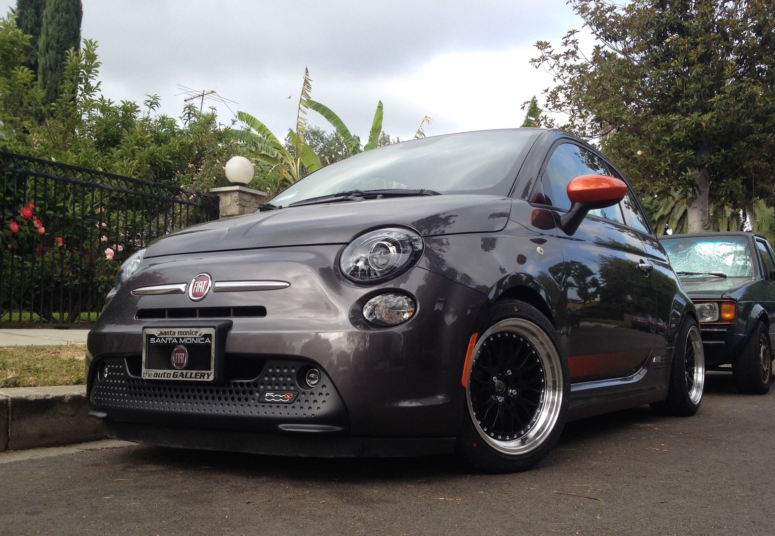

26 Posts
I put 16x8 et 25 wheels front and back with 260 treadwear 205/45/16 tires on my 2014. Handles better than it should on cut Abarth springs. Dealer said they'd charge me almost $800 for tires if i returned the car with less than an 1/8th of treadwear left. I'm in to this wheel and tire setup $678 including wobble bolts. I should be able to recoupe a good chunk of that when i sell them later.
