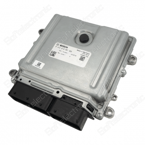

Got this error after finally my bpcm got fixed.
Car runs fine. But isolation test won't run.
Maybe somebody has detailed error description
Do you know where in battery is isolation sensor? Error seems to point circuit error of this sensor
Thanks

Update, this error is coming also from faulty bpcm, we installed another one and it's working. So now we need to compare both to see what's damaged

That's correct. I found local guy that is very smart and we work together, that's good lesson.
He fixed electronically my BPCM and trying to find what causes in it to make this error. Once all done, i'll write all about this:)
Currently looking for BPCM pinout
Reactions: 1
Finally after fight with bpcm till 3am we found another electronic element was bad. Fixed and now car is completly errors free :)

@caniggia just to confirm - the BPCM you had to repair was in the battery pack?

Symptoms and codes are identical, and they consistenly return after resets. I'm now working with the guy from Poland to check if we can diagnose or do something about this remotely, and will go from there.
Good news is that the pack cells seem to be okay. The positive contactor is stuck on open though.

I think you are working with guy where my car stucked for 4 months and was not fixed. Charged money agd stopped pick the phone for 2 months. I was lucky i was able to take my car and other guy fixed my bpcm in 2 weeks. I bet you have same issue as mine

Brought it to a nearby dealer paid $200 and got a similar printout regarding positive contactors which @caniggia posted and was told I need to replace the entire HV.
I have a feeling it may be the BPCM and am thinking of sending it here:
I think it will cost roughly $800 to do this, would it be worth a shot or should I just sell for parts? I live in NorCal
If you can post the BPCM log, we can confirm if this is the BPCM failure.
And if it is the BPCM, of course it makes sense to repair. You won't be able to buy an EV for $800.
