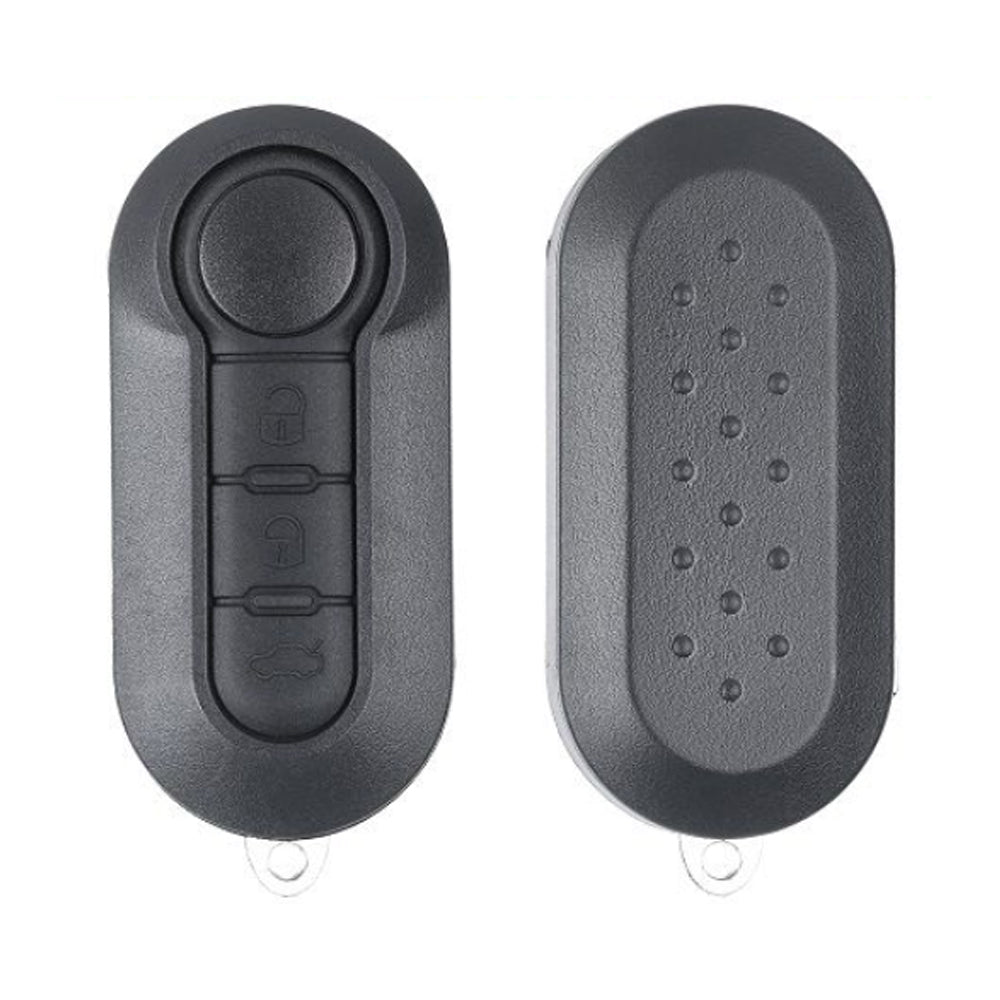

Here is the one linked in another thread:
It's a blank. Very unlikely that you'll be able to get it programmed. From the above site's programming page for FIAT.
Key Fobs for all Fiat car models must be professionally programmed by a local automotive locksmith. Key blade also needs to be cut as well. The Dealer may decline programming an aftermarket remote for you. To find a Verified Local Locksmith you can check out the "Find a locksmith" section at the top of our website!
It's the precoding that I describe in my detailed post that is missing. Unless you can find someone who can pull the secret code from the BCM and precode the key, it cannot be authorized such that it'll start the car or operate any remote functions.
But go ahead and get the blade cut. There should be a card in your owner's manual pack that has the code to give to a locksmith to cut it. Looks like this:
ga2500ev
